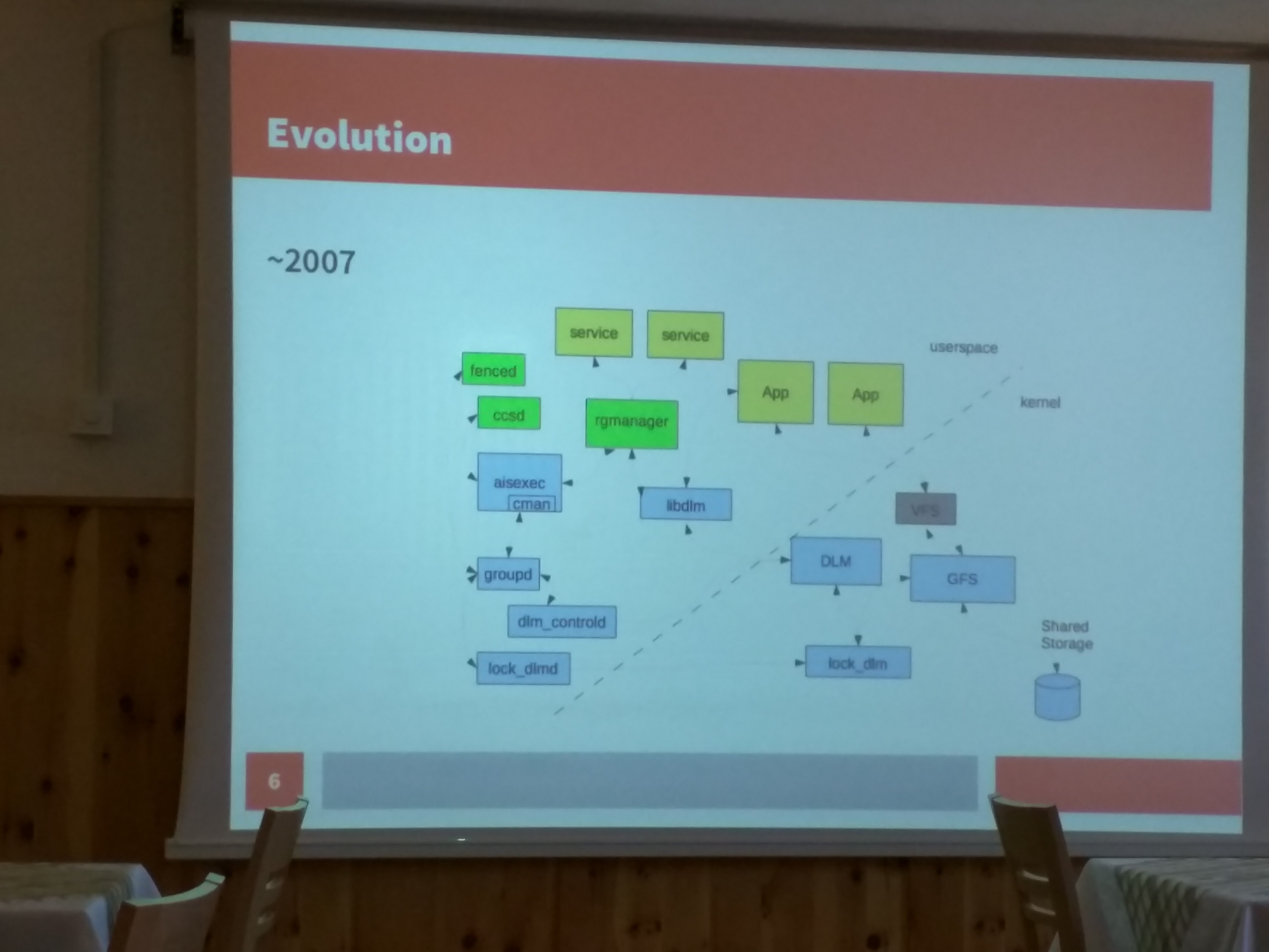

    Michele Baldessari: Linux Clusters – A short introduction
    Michele does an introduction of the cluster concepts and talked about the evolution of this kind of architecture (in year 2007 was more complex and hard to mantain than today).
    Quorum: the majority of active nodes take decisions in the cluster
    Cluster types: A/P, A/A, N+1
    Fencing: a mandatory mechanism that separates a cluster node from the resources it manages to prevent locking or data corruption if the node is faulty. Without fencing, a cluster cannot be called cluster!
    OCF scripts: a recommended standard for startup/stop/… scripts in a linux cluster (OCF stands for OpenClusterFramework)
    PACEMAKER: an open source resource manager software used on computer clusters since 2004. Until about 2007, it was part of the Linux-HA project, then was split out to be its own project.
    In the second part of the talk he showed us a practical demontration of a linux cluster running on a virtual machine (QEMU).
